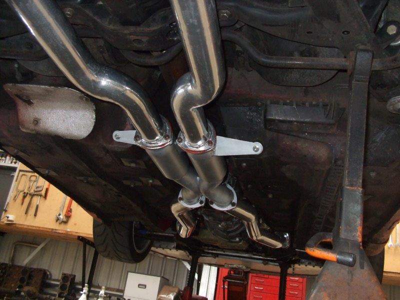

Was chatting about racecar exhausts and my mechanic said the exhaust must exit the vehicle cant dump under the vehicle (like you does behind the diff).
We did an exhaust like this - borderline on the 95DBa, but flows well.
So you might need to modify that too to get a logbook/pass scruitineering.Ensures all exhaust gases exit the perimeter of the vehicle behind the mid-point of the wheelbase except where an allowance is granted by MotorSport NZ and noted in the vehicles MotorSport NZ Logbook.

[quote="mikec(nz)"]Was chatting about racecar exhausts and my mechanic said the exhaust must exit the vehicle cant dump under the vehicle (like you does behind the diff).
[quote]Ensures all exhaust gases exit the perimeter of the vehicle behind the mid-point of the wheelbase except where an allowance is granted by MotorSport NZ and noted in the vehicles MotorSport NZ Logbook.[/quote]
[img]http://www.mdcracing.co.nz/redzexhaust16.jpg[/img][/quote]
oh ok thanks i will be able to cut and extend it in the future your exhaust looks abit nicer then myn

cheers for that. do you no the rules for exhaust going up through the cab and out the side in front of the back wheel ? thinking about doing something a little difrentDRFTIN wrote:as the guy who does most of the noise testing at Ruapuna i'm going to have a guess that the exhaust you've built there will give you one lap before we tell you to quieten it before doing lap 2
plus the body exiting issue as mentioned
